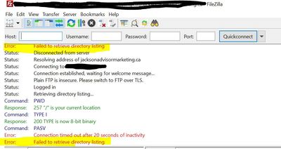

The only other issue I have when connected via ethernet happens when it comes to FileZilla and retrieving the directory of an SFTP server. Works great on my laptop via WiFi, not on my desktop via Ethernet.

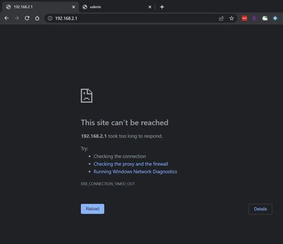

From my desktop connected via ethernet, I have internet but I can NOT even access the dashboard, see screenshot below:

Based on your second screenshot, we can see Valerie on the second tab, is it receiving the same error as the currently displayed tab?
Can you check on the back of your modem and make sure that your Ethernet cable is connected to one of the 4 yellow ethernet ports, if so try changing to one of the other 3 yellow ports to see if the same error occurs.
Just to make sure we're on the same page moving forward, are you trying to complete something specific via Valerie's admin page on your desktop, or is it simply that your desktop is unable to access Valerie's admin page?
07-21-2022 03:25 PM
Yes, Valerie on the second tab has the exact same error.
Yes, the ethernet cable is connected to one of the 4, I tried the other 3 and 2 different cables, same issue.
To be honnest, I don't really care accessing Valerie settings from desktop. My main issue is when I need to connect to one my client SFTP via FileZilla, it works from my laptop, but not from my desktop. Well, it connects to it but I can not retrieve directory listing, see error message. Again, no issues from my lapop. I assumed that it could be a similar issue than the one I have getting to Valerie settings.
