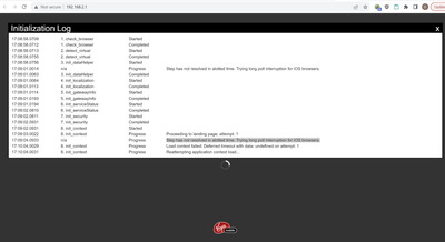

Hi,
I am unable to open 192.168.2.1 page on my laptop. This page opens in Mobile as mobile website where very limited functionality is available.
Reboot of the router also does not help and also I tried connecting the router with LAN cable but still the page does not open.
It just hangs here
I have tried resetting the router, after that the page works for some days and then again same thing.

No, When I say reset it means factory reset the router. So after factory reset, when I configure the router again to connect to internet, the page works for some days/some hours and after that again not working.
Power recycling does not have any effect (That is it does not fix the issue)
